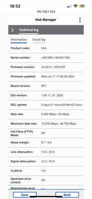

Please post a screenshot of your hub stats.
Advanced settings > technical log> information

Yes, you are capped at 40/10 although the best you will get with fibre 1 is only 48Mbps. In reality,  you are unlikely to notice the difference if moved to fibre 1.

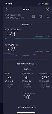

Thanks @licquorice, so do you not think there would be a noticeable difference between the 37ish we currently get (not always that good) and the 48? Appreciate the reply!
Have attached a speed test taken just beside the hub for reference 🙂

Message 6 of 27
Re: Speed cap at 40/10 but line capable of 54Mbps
Depends what you use the internet for.
Unless you are streaming multiple channels or downloading large files, you won't notice the difference.

BT Home Essentials is the social tariff for those on qualifying benefits, the ‘standard’ version is 40Mb , there is a ‘faster’ social tariff, BT Home Essentials 2 is the equivalent of F2 speeds ( 80Mb profile ) ,
If you wanted 55Mb even though you line can’t quite reach that , but can go a bit faster than 40Mb , you presumably would forgo your social tariff and be paying the normal consumer rate, as 55Mb doesn’t have a social tariff….
a further complication is BT confusingly sell ‘Fibre Essential’  ( not not to be confused Home Essentials ) which is also a 40Mb profile , it’s not clear to me what the OP actually is paying for , BT Home Essentials ( social tariff) or Fibre Essential a regular consumer offering.
