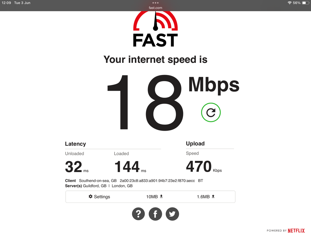

Recently had upload speed drop from around 4mps to almost zero. Download has been steady at around 18mps. Sent new modem to see if that is the problem. No difference. Engineer came today reset brand new modem using pinhole reset. Tells me the cache probably needed clearing even though use only for 48 hours. Showed me the read on his tablet of 8mps upload. A speed I have never had in 15 years. Me happy. He leaves. I do speed test. Upload still near zero. Any ideas? I have used ethernet connection on test. No difference. Have I been had?

do you get same result using ethernet connection and trying   fast.com
what connection speeds do you see in the BT hub stats?

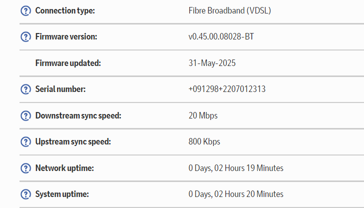

Re: Upload speed saga
Go to solution

can you please go back to hub manager then advanced settings then technical log information and post the full stats from there.  you up connection speed is very low hence why download speed is low

there is a problem with your connection as your attainable for both up/down is far higher than your actual connection speed.  provided you have not moved to digital voice can you try dialling 17070 option 2  it should be silent with no crackle.  have you tried using the test socket with a filter to see if that improves connection speeds?

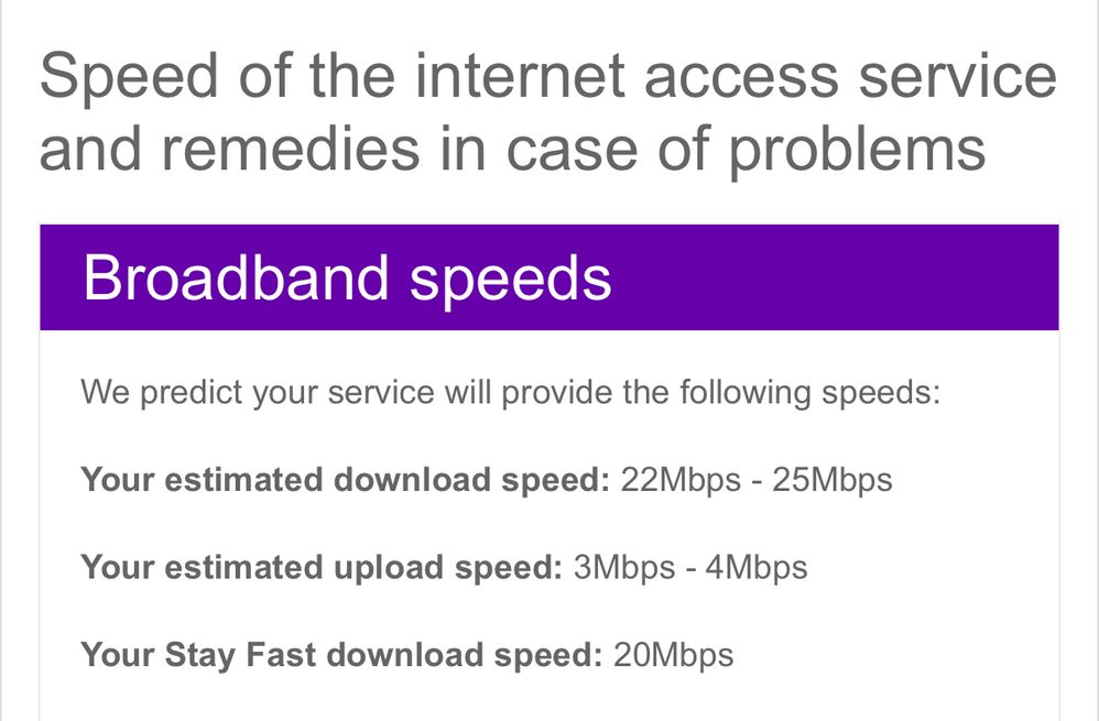

Go to solution
Here is the quote from the 2023 renewal. It has now expired. They have now reduced the minimum to 15mps.IMG_1994.jpeg
