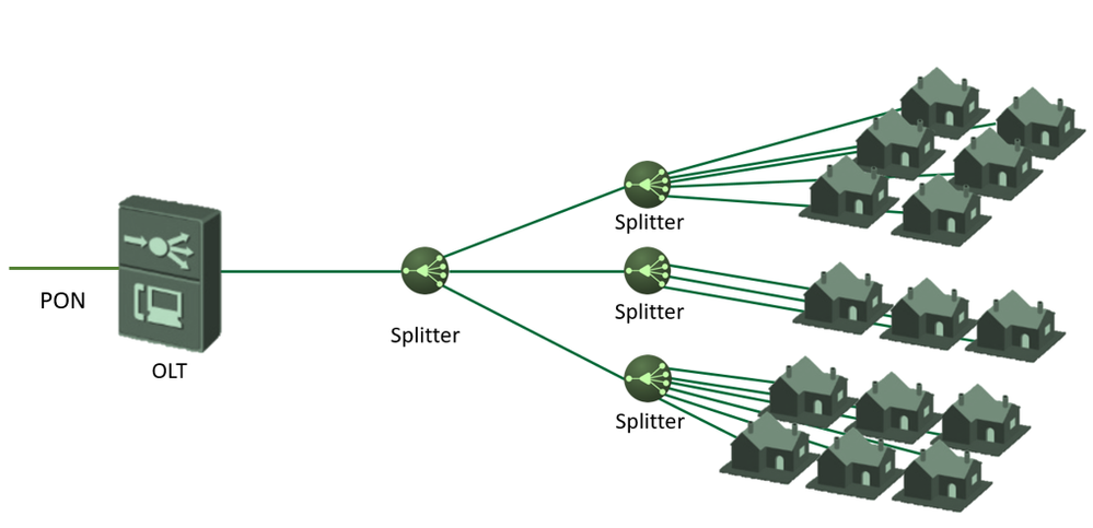

My reason for being shocked is that I thought with full fibre you had your own line dedicated to your house which eliminates interference etc or am  I wrong.

Full fibre is entirely different to copper distribution.
There is a single fibre feeding your distribution point that is split between up to 30 customers.
