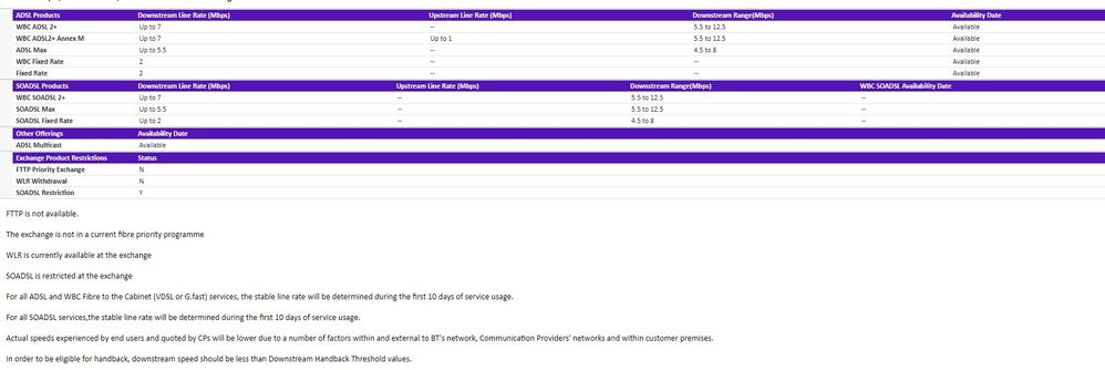

Does anyone have any advice/help? Is it possible to get connected to the cabinet? I have attached results from the wholesale checker.

If you are connected direct to the exchange and not a cabinet then you will not get FTTC nor can your line be moved to the cabinet.  You now just need to wait until FTTP is available in your area

FTTP doesn't come from the cabinet. The checker indicates FTTP not available and the exchange not an FTTP priority.

post code checks are unreliable and really needs to be phone number or address
is there a cabinet shown onthe top of the dslchecker results  if none then you are connected to exchange

There's no cabinet at the top no, however our direct neighbours are connected to the cabinet when you have a look at their results. Are we just in the unfortunate position of being in the cut off? Just frustrating as we are within touching distance.

Its not a problem of a cutoff point but that you are on an exchange only line. Openreach will not go to the expense of re-routing your line from the exchange to a cabinet.
