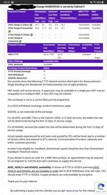

I'm in a similar position to the OP but we are fully BT (halo EETV mobile) A year ago i was told that we are not in an area for FTTP.
A couple of weeks ago our neighbour had fibre installed not via a nearby CBT but directly from underground. The BT engineer said this would not ease our problem and that the CBT was too far from our premises to use one of the vacant slots. This also applies to all properties to the west of us including a primary school, 14 flats and a few other dwellings. To the east there is a paid for fibre installation covering a few dozen properties.
This morning i ran the address checker again and saw that FTTP is available. Please could you advise if i am misinterpreting the results. Ours has the address obscured in red
I have included the FTTP neighbours results (obscured in black) for info

The ‘red’ address doesn’t have native FTTP available, but FTTPod ( a different product ) the ‘black’ address does have native FTTP available and FTTP can be ordered .
FTTPod is a product where you pay for the optical network to be built to your address , so can be costly depending on how far away the existing network is , if someone does have deep pockets and pays to get FTTPod , their immediate neighbours can benefit as ‘native’ FTTP becomes available for them .
Anyone  who pays to have FTTPod , after the original FTTPod contract expires, can change to native FTTP , but it’s not a cheap way to get FTTP .

So the neighbour has had FTTP installed. I think you are implying that I can now piggy back on their installation "their immediate neighbours can benefit as ‘native’ FTTP becomes available for them"
Is that why the red broadband checker (mine) now says available?

It’s really impossible to say , if ( for arguments sake ) 8 addresses in a cul-de-sac were not part of a nearby native FTTP scheme, and all 8 addresses were served from the same point , and one benevolent homeowner paid to get FTTPod, the other 7 would see native FTTP as available.
In this case it may be FTTPod , or it may simply be that in an exercise to increase the FTTP footprint a neighbour that was originally in the same position as you ( not having FTTP available ) has benefited from the network being expanded, but that expansion hasn’t benefited you .
A PON ( passive optical network ) is designed to include a certain area , there can be occasions where very near neighbours are either side of the PON boundary, so one neighbour can get FTTP and the other cannot .
A way to visualise this , imagine a road that runs West to East , 10 houses in total on the road ,houses
No1 to 5 the duct feeding them comes from the West side , the duct feeding No 6 to 10 comes from the East , so although No5 and No6 are next door neighbours, they are on totally different duct routes,  and that could mean at some point , one will be included in a PON  and have FTTP available, but the other isn’t , underground ducts are invisible so to the ‘layman’ it seems weird that one can neighbour get FTTP and the other cannot , but there will be a physical restriction.
