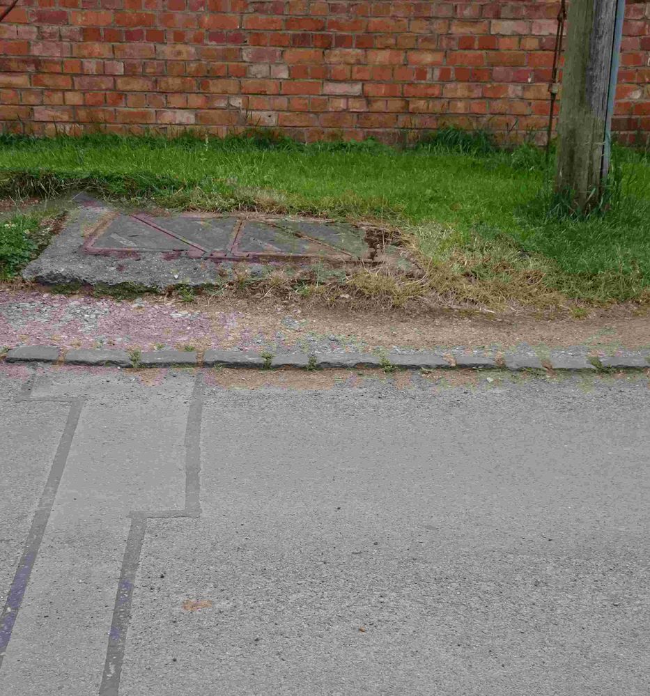

Care to take a picture or two ( and post them ) of the excavation outside your address and outside one of the completed installations ?

Yes, no problem but will probably have to be on Wednesday when I will be WFH and hopefully most of the neighbours will have removed their vehicles

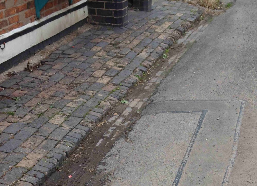

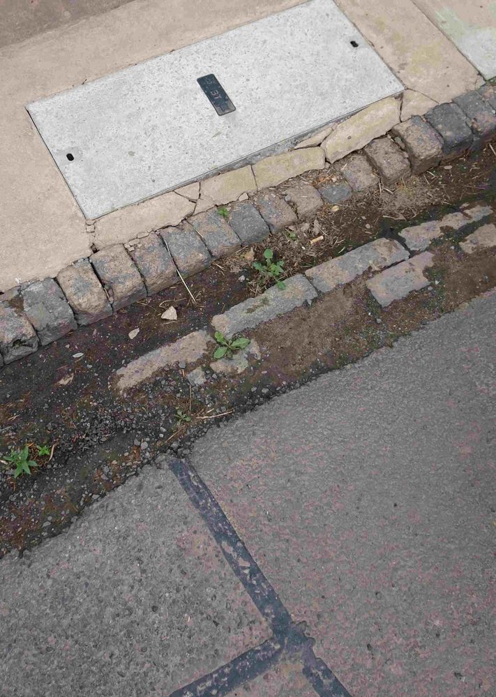

outside houseoutside houseDSC02772.JPGNeighbours house with fibreNeighbours house with fibre

Unfortunately the images don’t particularly add to the sum total of knowledge, I assume a ducted road  crossing now  exists from the  carriageway joint box ( with the metal lids ) at the foot of the pole to a new small joint box possibly a JUF2  in the footpath on the same side as the properties in question, but nothing obvious from that box onwards…..with the footpath being cobbled ,  it’s not like excavating in tarmac where the reinstatement ‘scars ’ remains witness to the excavation, so it’s unclear what , apart from the jointbox was also done ….,
I would have expected that toby boxes to have also been provided in the footpath outside each address, or possibly a toby box for a pair of dwellings, situated at the mid point so capable of servicing two addresses , the image showing the address that apparently now has FTTP , shows no evidence , like a toby box , duct against the house wall , capping ,  CSP , although there is a picture of a scar in the carriageway outside presumably your property , and possibly designed to also service No.11 , it seemingly just stops the the cobblestone footpath , does every dwelling ( or pair of dwellings) have a similar scars  in the road ?
If the scheme was intended to provide availability to all 8 dwellings ( I presume it’s 8 as there are 8 front doors ) , then I would have expected much more in the way of ‘evidence’ of the work done …..given the tiny size of the footpath, and pretty old construction ( you don’t see cobbled footpaths very often ) I wonder if what was planned couldn’t be provided completely , perhaps there  just wasn’t the room under that footpath for new ducts etc,  and although some work was possible  , hence some addresses showing availability , perhaps it wasn’t possible to get any new infrastructure outside your individual property.
I suspect the only way to know for sure  is to start a dialogue with Openreach via the link posted earlier , they may contact you and explain the situation, but as far as individual ISP’s , including BT , they only ‘see’ the current survey information , and raising an order won’t be possible until that information changes , or is confirmed as correct .
