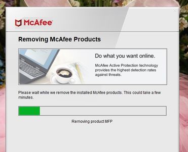

I have been trying to uninstall McAfee from BT so that I can install Norton as told by BT.
I have tried several times to uninstall it using Control Panel without success, and I have also tried the McAfee uninstall tool. This starts the process but the stalls at 'uninstalling MFP'.
Any suggestions please?

When you say the McAfee removal tool stalls, how long did you leave it? On mine, which has an SSD, it took around 20 minutes to find and remove everything.

Thanks for all the answers/suggestions.
I've tried the Control Panel option again, but no success.
I've tried the McAfee option again, but it stops at Removing product MFP. I've left it now for nearly 5 hours and the green bar hasn't moved.
Steve P

Thanks for the help and suggestions.
I ended up using one of the methods _dreamer_ suggested from the McAfee site below:
  1. Rebooted in safe mode
  2. Deleted all McAfee folders in program files and program files X86, (and Program Data),
  3. Ran the Removal tool. (didn't seem to finish)
  4. Rebooted to normal,
  5. Ran the reboot tool.(Don't know what that is)
  6. Rebooted
A couple of McAfee folders/files were difficult to delete but managed it. The MCPR 'green bar' went further this time but stopped at about 3/4. Left it for a few hours then restarted the pc.
The McAfee item has finally gone from the list in Control Panel, and when I searched for McAfee on the C: drive nothing came up so I'm guessing all have been deleted.
Norton is now installed via my BT. Waiting to see how this performs, I used Norton many years ago but stopped because I found that it slowed my PC down significantly. This was ages ago so I'm sure it has improved....
Thanks
