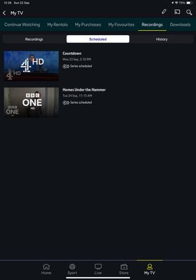

@martinandhazel
Here’s my Schedule in the EETV app - definitely has the double )) and in addition says ‘Series scheduled’.

Re: BT box not recording Series as requested
I believe that for the specific example of the upcoming The Graham Norton Show it is not  a user box problem.
The EE TV app does seem to  display scheduled recordings for new and newly requested series recordings in a somewhat confusing way.
So if @Midnight_Voice  you used your EETV app to  (series) record the new series of The Graham Norton Show on BBC 1 HD this Friday night you might well see that the EETV app (after allowing time for the request to go back and forth) that your EE TV app schedule only shows Episode schedule. That is what I noticed when I set the series  recording this evening on the app.
Further if I look at the EPG  guide entry on the TV box or the recording schedule on the TV Box they show that The Graham Norton Show is indeed a series recording from Friday ‘s opening episode.
The  EETV app guide and recording schedule on both Samsung phone and IOS EE TV apps only show it as a single recording.
Taking it a stage further I set a series recording for Countdown  on C4 HD from Monday  ( the subsequent episode in series being on Tuesday). The Monday episode shows as an episode recording in the EE TV app schedules and the Tuesday episode shows as a Series recording.
