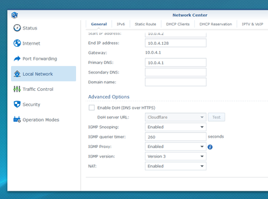

What I have tried so far is:
Enabling IGMP snooping
Enabling IGMP proxy
Setting IGMP version to 3
However, none of these have worked. I'm wondering if I should be setting anything on this page?
 Any help is much appreciated! Thanks a lot

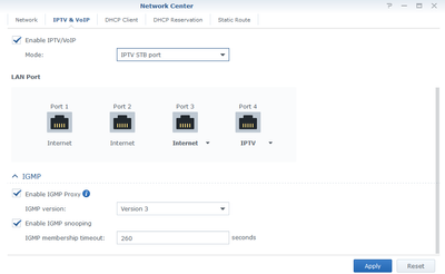

Unfortunately wiring it in directly had no change! I even tried setting the port as a dedicated IPTV port on the router (screenshot below) but that had no effect either.

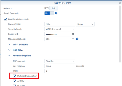

On the WiFi front, I updated the firmware on the router to be the latest and greatest.  I made a new SSID for the box and kept IGMP proxy and snooping enabled (as in above screenshot). Also ensured that multicast was enabled:
Still no dice :S.
