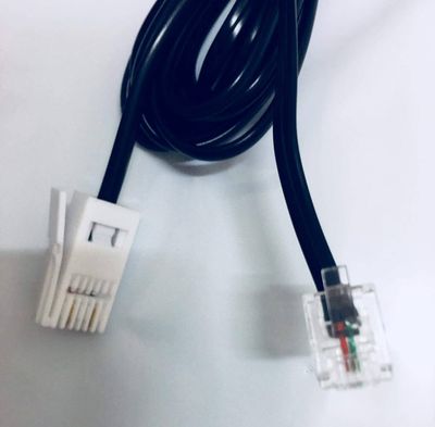

Might be worth a factory reset of the base unit, which should be detailed in the manual. Or maybe the cable was on it's last legs & has died in the move. There are two types of cable, straight & crossover, you almost certainly need straight.
Both the RJ11 & BT431a connectors have six pins, but 1 & 6 are never used. At the BT end, the signal is always carried on 2 & 5. But at the RJ11 end those wires can either also go to 2 & 5 (straight) or to 3 & 4 (crossover). With the aid of a magnifying glass or a heavily zoomed image from your phone, you may to able to just about see the colours of the wires, & therefore identify which is which. You can then rummage in the cable box for a replacement or resort to Amazon/Ebay.
If the other cable is also straight & a reset doesn't work, then it looks like a faulty base.

It's green and red, pins 3 and 4. Looks like this. This is the cable supplied out of the box. I'll have to try the factory reset then because with several cables tried, I doubt it's the cable, and as it all worked fine before the switchover, thanks for the response.

If that's your cable & not a pic from the web, it looks wrong. The RJ11 is connected to 3 & 4, which is crossover. That might be correct but much more likely to be straight & connected to 2 & 5, same as the BT plug.
But if you're saying this is the cable it worked with originally then it must be crossover.

It's from the web, but only because I don't have time to go back over and grab a picture, but I can assure you that's what it looks like the two cables were in the middle. As to it being wired wrong on the master, not sure, don't know enough. I'll take another look next time when I'm over there and try the reset also. But that seems unlikely if it worked before and the other phone worked okay also?

As I said, it might be correct but every piece of BT kit I've encountered over the last 10 years or so has used a straight cable. See if you can find one to take over there to try, just to rule that out.
In the majority of Line Cord errors reported on these forums, it's been due to a mix up of cables.
