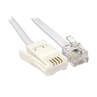

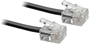

It is sompletely different from old box in old home, which had sockets to connect phone and adsl wires ( like those shown below.
The new BT OpenReach Wall box in new home does NOT use phone and adsl wires like those above.  It uses ethernet to connect to BTSmart Hub 2 (the old one I was told to take from old house to reuse in new home).  A second ethernet was required to connect hub to pc - NB BT did not supply this essential second ethernet cable but luckily I found an old one of my own to use.

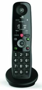

I think this is because my old BT Essentials Digital Home phones ... like this one ...
are not compatible with new set up?
Also only one worked - the other crackled during calls - (also lost /misplaced cradle during house move.  Have requested a new one but not sent!
BT keep insisting that I plug in to the back of the Hub - but I cannot do this!  As anyone who knows the phone would realise, the phone connects to the cradle /  battery - and then the cradle plugs into the electric wall socket - but there is no socket to connect phone or adsl wire to hub or adaptor.
Been asking for new phones, but BT refuse and insist my old phones will work!  I am also told I only need one phone and that is all that their Terms and Conditions say I am entitled to!
The most they will do is send me one DV Adaptor - but I see that you need to plug one of the phone wires (shown above) into the Adaptor so that will not work.
Pre BT Fibre installation at my old home I had decent answerphone and 2 handsets that I had purchased myself previuosy - but BT told me they would not work with new system and that I coudl only use the new DV phones they were sendin gme - so I gave the old phones and answering maching to Charity Shop.  Now existing BT DV phones wil not work and BT will not send me phones that do work with the sockets / system I now have.

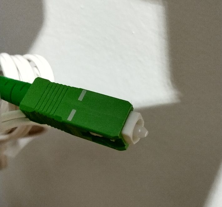

BUT there is NO "phone" or "adsl" socket on my BTOpenReach Wall Box,  There is an ethernet socket, a power socket, a tiny on off button and a green socket of a type I have never seen before - see below.  It is attached to the wire that comes in from outside and connects to the BTOpenReach Box on wall.

the phone pick is an extension phone but you need to connect the base unit to the green socket on the back of the hub using the same cable as was used to connect existing base to the old style master socket

I do not have a "base unit". The phone BT have supplied me with has no socket to connect to anything other than the battery cradle!

Can you tell me which phone I shoudl ask BT for, please?  If the one I have is only an extension phone.  They never sent any other type for my old connection at old home - and have so far refused to send mew phone for this new home . new connection and are insisting that I use the old one and insisting it will work with new system - and ignoring me when I tel lthem it will not.
I do see images of a telephone that has a sort of console attached to the side of the cradle - but I do not have one of those.

if you go to hub manager the select your phone number then you should be able to pair your phone to the SH2 which acts as a phone base unit.  it connects using DECT not wifi. no cables are needed to connect phone and all you need is small charging unit to charge phone
