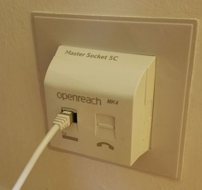

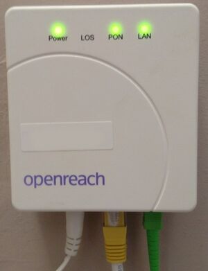

As @licquorice  has said but thought I would give you some pictures to help:
A) Master (NTE) Socket
B) ONT
6,832 Views

I have the Master (NTE) Socket.
The other master socket that i mentioned in the OP is a NTE5a.
