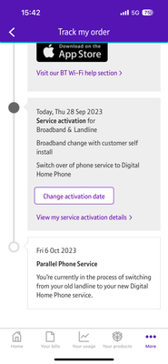

The reason I'm asking this and before anyone shoots me down, I know today is the activation day but I have "paralell phone service" that has appeared on the order tracking (screen shot attached)

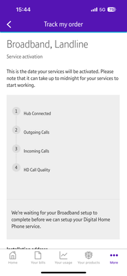

Further to this there is a section in tracking where it says waiting for your broadband setup to complete before we can set up digital voice (also attached)

Hi Thanks for the quick reply.
Fibre1 I currently still have, they have said there switching me to fibre essentials. It's almost like the system doesn't know there is active broadband on the line. 🤷
This is the normal expected behaviour, during the switch to DV the service will run in paralell with the PSTN service, you'll still be able to receive calls on the PSTN until you setup your Smart Hub 2, once the Smart Hub 2 is connected the hub will make a test call to download the SIP credentials for Digital Voice, once that completes then inbound calls will be routed to the Digital Voice service and the port will complete so you retain the same number.
It happens on all PSTN to Digital Voice migrations, the paralell service is so you don't miss important calls, it runs for 5 days to allow customers a chance to connect the Smart Hub 2, if after 5 days the hub isn't connected, the DV service goes live with the port regardless.
You mention downgrading from Fibre 1 to Essentials, it's most likely that element delaying things, it will complete today so the system will wait for a supplier update to confirm, then progress the order for DV
I strongly urge you not do anything but wait, your order is now past the point of no return, you do not want anyone trying to mess with it, just let the system do its thing 🙂

As you say about the paralell service and it giving customers chance to install the smart hub 2, because mines already connected would it be worth factory reseting it? As on the order tracking pic above the number 1 hub connected it's greyed out? Hence wondering if the reset may be needed.
There's usually no need to do a factory reset, there's a step by step setup guide at Digital Voice: How do I set up my service?
