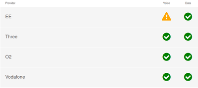

Does that only work if there is no signal at all from your own network, or is the best signal available selected by the phone when making a 999 call?
For example, I am currently with Plusnet mobile, (it was the same with BT Mobile and EE who I know all use the EE network). My signal at home has never been great and seems to have significantly deteriorated over the past year or so, such that the OFCOM signal checker shows this for my address:
I can still make and receive calls at home, but positioning is key for a good call. Would my phone select one of the other three networks if I were to make a 999 call?

A mobile can use any available network provider to make a 999 call.
See https://landlinesgo.digital/powercut for more information on how to make calls in a powercut
