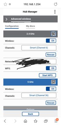

Message 7 of 15
Re: BT Full fiber 900MBsw
Yeah the here they are
I would download a Wi-Fi inspector app to see if there is a possibility of co-channel interference from another device.
Try switching off 5g and manually selecting another 2.4g channel. If there are “radio modes” available try mode 2.
Obviously change one thing at a time to isolate the issue.
Checked the network for the channels and everything seems alright.
Also tried changing modes, thinking of asking for another new SH2 Maybe it'll fix things.
