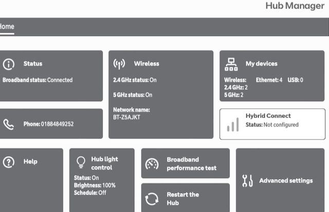

On my laptop I go into my BT Hub home and `I find this menu. Is this where I can find all the information I need?
Now what🤔 and where do I find this SSID thingy please?
My son set up the TP-LINK and he kept all passwords etc the same as the Hub.

Its the network name shown in your screenshot in the wireless box.

Yes it is, same as the little pull out tab on the hub where the passwords are.
