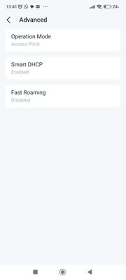

@Keith_Beddoe
Thank you.  I have updated to 'Access Point'.  Can you please advise if below looks correct?  I cannot see an option re the other update you advised?

@VINC3
Its just unfortunate that the initial setup of the Deco, is very confusing, and is really aimed at cable routers, so it defaults to router mode. It has to be changed once a connection is established.
I would tend to leave it in Access Point mode, even when you get FTTP, as you are going to need to keep the home hub connections for BT TV.
Its not going to work in router mode on FTTP if connected directly to the ONT, without entering PPPoE credentials, so its best lest in Access Point mode for simplicity, especially if you have any issues with the FTTP connection in future.
3,027 Views

@Keith_Beddoe
Thank you so very much
I do not have BT TV and I totally agree, the initial set up of the Deco was very confusing and unnecessarily confusing.
Can you please tell me if below looks correct and should I be looking to find 'Beamforming' - that you mentioned previously?
