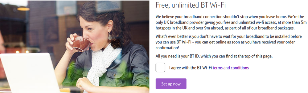

I tried that link and it only seems to can enable it there - the box is unticked. No other option appearing.
Page doesn't seem to work.

This is what I see but I haven't tried it

I can't find any options like that - the pages are all different.
All I get is this page - which errors if you try and do anything.
It seems to be a setup page - the issue is I want to remove it.
