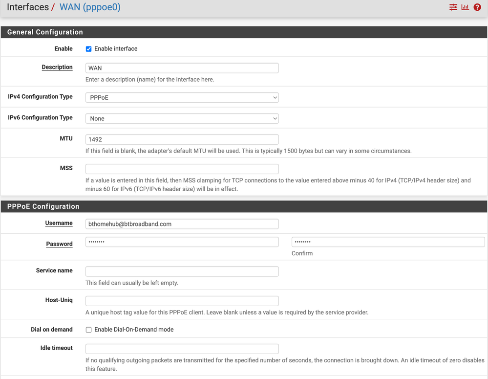

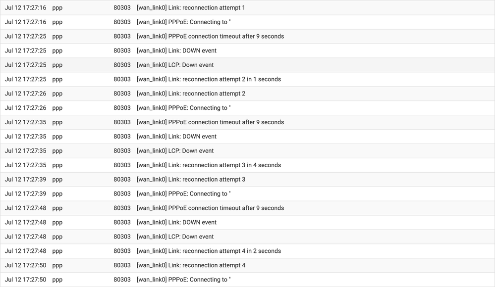

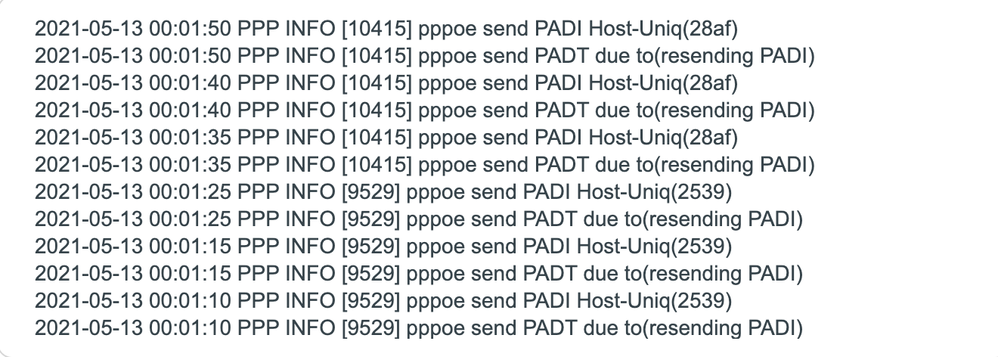

None of those MTU settings seem to work on either setup (pfsense and tp-link) 😞
pfsense wan configpfsense wan configpfsense PPP logspfsense PPP logsTP-LINK PPP logsTP-LINK PPP logs
(don't mind the log date on the above, I have corrected it and tested)
