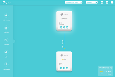

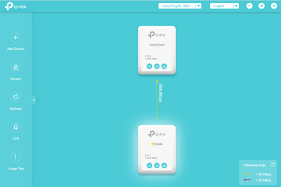

So, I start tpPLC, the application to manage the powerline and see this:
Which, beside the weird behaviour of having a higher rate upward (toward the router adjacent powerline) rather than downward, still shows that there is bandwidth between the two powerline adapters for at least 500Mbps. While I was there, I also updated the firmware on both to the latest version (Apr 2025)

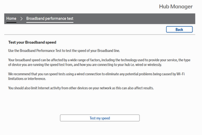

The next step then was to check the router speed. And here is where things get even more confusing for me.
When checking from the website, this is what I saw:
This is the third time I run this from my PC, so forgive me if I don't press the button again. Goes without saying, that nothing changed (or I wouldn't be creating this topic).

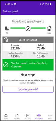

Now, from my phone app, this is what I am seeing instead, when I run the speed test:
So, which one is correct here? Does my connection need improvement, or it's perfectly fine? xD

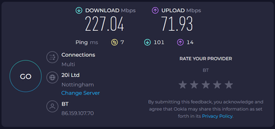

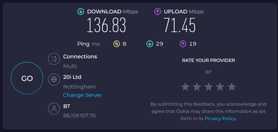

Just for completedness, this is a test run with speedtest.net:
Let me throw a last curveball here, this is a test ran using the Wi-Fi connectivity instead:
So, better, but still not even close to the 500Mbps I should get. Which is irrelevant anyway as the two powerline have clearly a detected bandwidth of 500Mbps and up and are rated to support up to 2000Mbps (I know, it's never really that).
