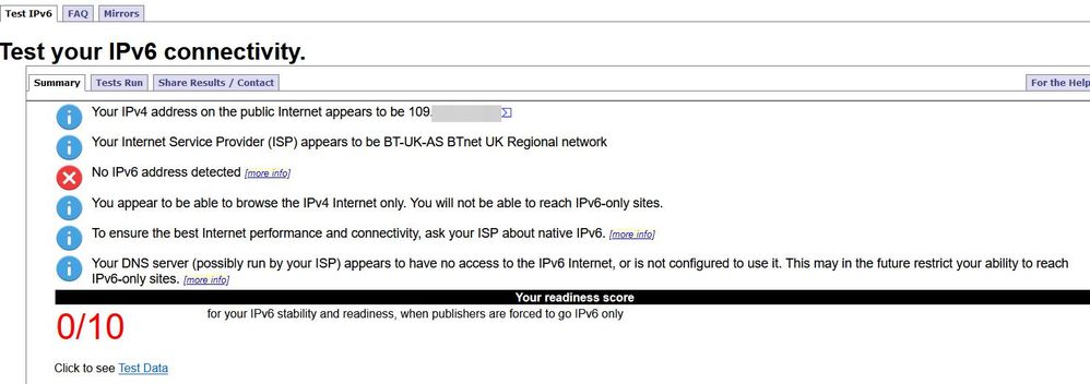

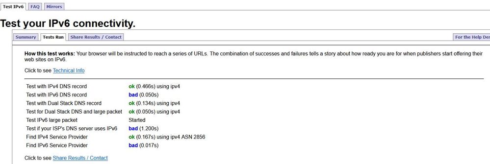

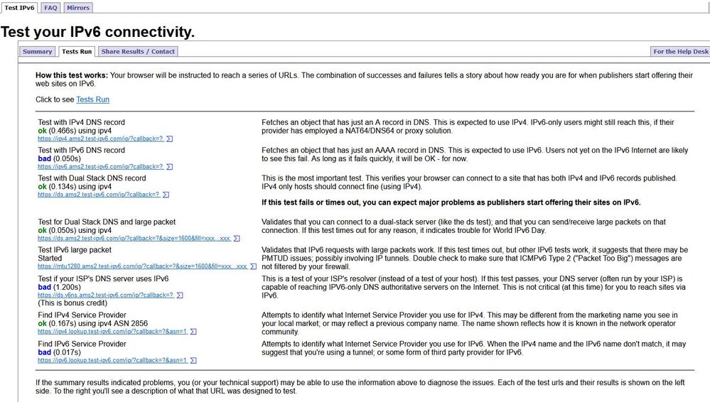

Hi Robby,
I sent my details via PM as this full message too, but would not send due to HTML Error?
test-ipv6.com
IPv6 test sites report that I am not using IPv6, when ULA is 'OFF' in the router (default setting), IPv4 and IPv6 are connected from the PC (ticked as on) in LAN properties (Cat 6 LAN cable on 1Gbps ports) and both DNS and IP on Auto Negotiation.
It's all set to auto config (before I used quad9 DNS hence it gave me a green tick for that, but changed it to Auto (BT) on both IPv4 and IPv6) – connected via 1Gbps LAN and get 800-930Mbps and now get the blue "!" no IPv6?
When all set to BT (Auto Neg) - the site above reports that I am not using any IPv6 whatsoever and get 0/10
So I'm at a bit of a loss as to why this site reports these:
IMAGE 1IMAGE 1IMAGE 2IMAGE 2IMAGE 3IMAGE 3
Can you help with this issue? I have tried Chrome, Firefox, and Edge browsers (no extensions) all with the same results?
I am tech-savvy so know my stuff, and I can't fathom why this site reports it? Not only that, but I don't use a VPN or 3rd party DNS (not for testing)
This proves what I say about using a 3rd party DNS like Quad9 gave me a green tick on that, but on BT I get a “no result” (cant connect to IPv6 sites).
The one on the thread was using Quad9 DNS, I thought was on auto-neg. Hence, the green tick on IPv6 DNS
regards
Snadge
3,816 Views
Message 15 of 17
Re: no IPv6 despite it being on in router and Windows x10 ethernet adapters?
Go to solution
I have sussed the issue:
LIBREWOLF - USES IPv4 BY DEFAULT!
You have got to go into Librewolf's own settings (in settings) and enable IPv6..!
when rerun I get 9/10, no green ticks (or 10/10) because BT uses IPv4 DNS only - it says so even in the router.
edit : strange that other browsers (especially chrome/edge) yield that same result?
thanks for the help guys and gals
