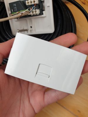

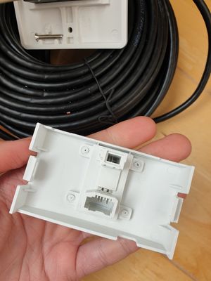

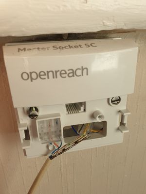

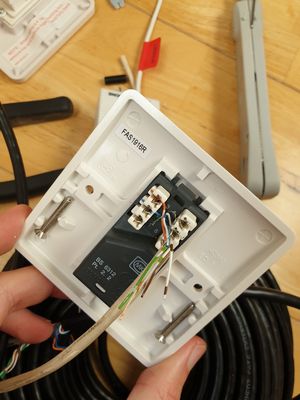

Hi,
The previous owner of the flat had an extension cable running along the walls, so I decided to make it neat and conceal it into the wall. I cut off the old extension, got cat6 cable and MK slave phone socket, connected blue/white to 2, orange to 3 and white/blue to 5 on both ends, but when I plug my router into that extension socket it complains that it is not connected. I use the provided ADSL filter to plug it into both master and slave sockets. I have tried not connecting orange wire at all, but no success. I have also tried a piece of cable that remained after I cut off the previous extension but with no avail.
Can it be a faulty extension socket or I am doing something wrong? I think master socket
should be fine as the old extension used to work.

Have you refitted the plate to the master socket? Extension wiring is disconnected from the incoming wiring with it removed.

I did, but I don't see anything on the plate that would affect the extension somehow.
7,932 Views
See around 6:30 on this video:
https://www.youtube.com/watch?v=CkFMfB-DYmQ
So to be clear, are you saying that the master socket no longer works either or just the extension?
