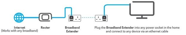

If the Humax has an Ethernet port, you might be better using a pair of powerline adapters and connect via Ethernet rather than wifi.
Something like these https://shop.bt.com/products/bt-broadband-extender-600-kit-084284-BVFL.html

It does indeed have an ethernet socket, I understand that but only ever used a wired connection
so does this gadget plug one into the Hub and one into the Humax and transmit a wireless connection between?
Mary
No, it uses your mains wiring as an Ethernet connection.

now that does interest me, I have tried and thrown out wireless music because the sound quality was so poor compared to my wired hifi, so a wired solution will give me confidence, thank you so much!
