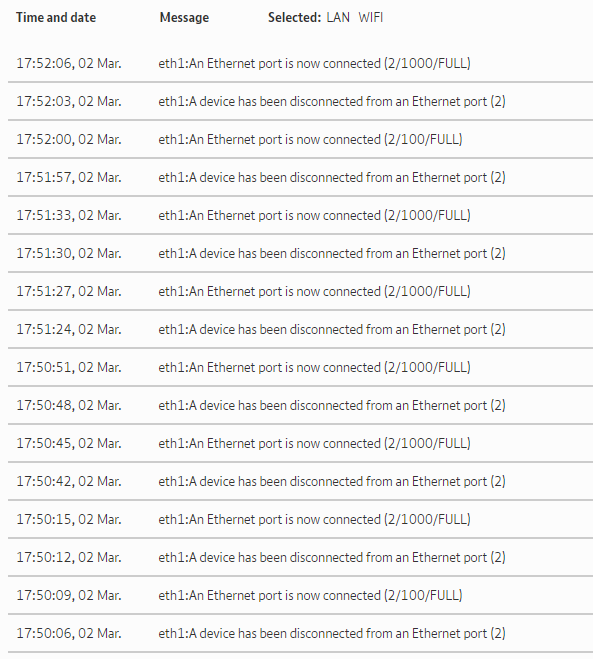

Thanks again for your time & help. Just wanted to attach this picture, to show you how crazy the disconnects are, all within 1-2 minutes...

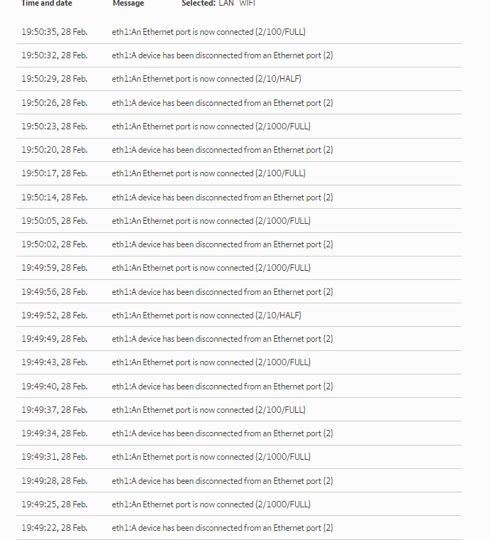

Right, you might as well put that connections setting back to auto (you are using an ethernet connection ?)
Looking at that log, the connection is connecting at 1000mbps then connecting at 100mbps suggesting that the connection is failing somehow.
So  you have a connection to the wall socket to your hub, then you have a PC on ethernet and that link is connecting and disconnecting ?
Those last logs are very different to the first log. The last two show an ethernet connection failing, was the first when the same machine was connected via wifi ?

Yes. Wall socket -> hub -> ethernet/PC, and the hub MOSTLY stays blue when my PC has disconnected.
The pictures of the hub's log have been of WiFi and Ethernet, my PC is connected to ethernet in those screenshots.

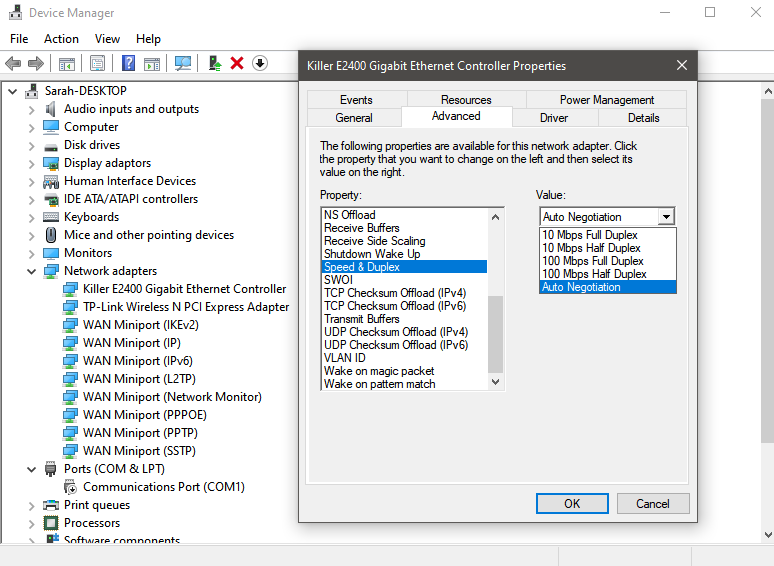

I have the WiFi turned off on my PC since being wired. Would that cause complications perhaps? 😓
Would these settings in Speed & Duplex do anything? Thank you!

I think there are two things you can try to see if it stabilises the Ethernet link.  In the settings you displayed set the link to 100 Mbs Full Duplex instead of Auto negotiated and that should stop the flopping between 100 and 1000 Mbs. If that does not improve try plugging into a different port on the router.
