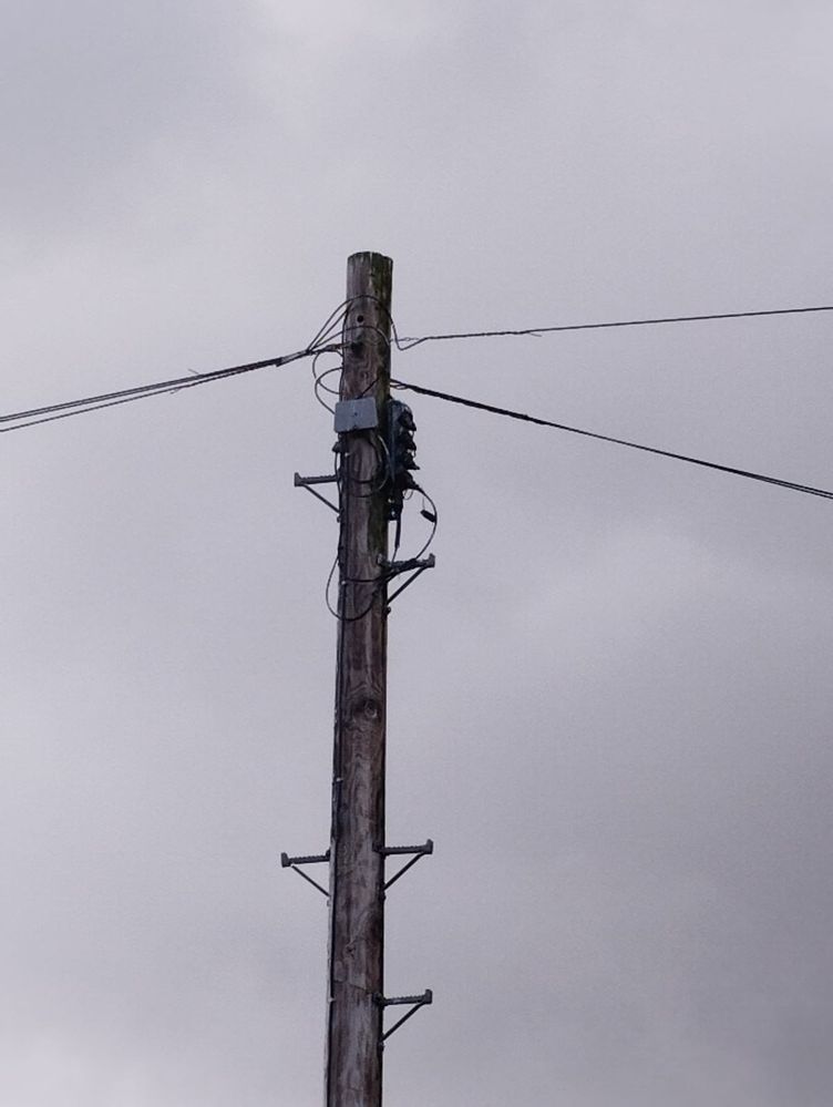

I've taken another look at this and I've been told that I can join the two ductings in the original post and just put a solid step over it.  This will prevent BT having access to the cable between pole and inside of house.
I've checked the setup and it looks like there is a grey box up the telegraph pole outside our house - would this be the CSP box?  If not, what is it?  Can the CSP be installed up the pole?
Grey box on telegraph poleGrey box on telegraph pole

The Grey Box is a BT66b and is used to house Copper Cable Joints. It has nothing to do with FTTP.
The back block the the right is a CBT, that’s for FTTP.

The CBT (according to the post from 36ULW) is on the pole to the right of the grey box. The distance from this pole to my property is approx 25m - maybe closer to 30m for cable length.

Hi @Dave_77  Thanks for your posts, from the picture of the pole you have posted it looks like there is full fibre infrastructure in your area. If it's available you won't be upgraded to it unless you place an order, you can check if you can order it by logging into your MyBT account.
If it's available and you want to avail of it why not place the order for the installation to happen before you commence the building of your steps?
