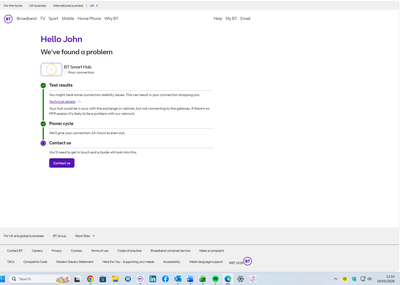

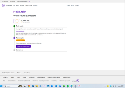

With respect @iniltous, BT's own online test is now identifying the stale PPP session fault on an almost daily basis (enclosed) and it has been witnessed by Customer Support Guides, during numerous telephone conversations. I would reiterate that VOL053-8502009814494, is the 85th recorded fault with my service, since upgrading to Full Fibre and politely point out, that it is the BT guides, who have scheduled the 15 visits by either a BT or an Openreach engineer. For your information and although it is rare, the red LOS light has come on briefly, but more often than not, it is a flashing green PON light, that is shown upon the ONT. Correct me if I am wrong, but doesn't this confirm that my problem with the incoming light signal is external. Therefore and from my humble perspective, as it has now been ongoing for some time and as every other item of equipment has been exchanged on numerous occasions, I simply believe that the cable should be replaced, if only to eliminate it as the cause of the issue.
