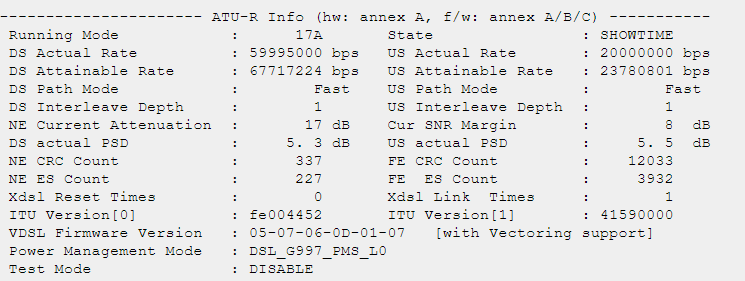

Hi,
Hoping someone can help as my connection is being limited and seems stuck on a banded profile of 60/20.
Line is stable for over a year now.
Can someone please look into remove the cap so as to achieve full potential of the line?
Thanks  🙂

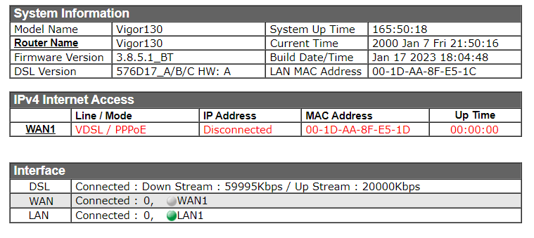

your stats, probably tplink, don't show internet connection time or system up time
4,800 Views
Message 4 of 28
Re: Banded Broadband
Go to solution
Its a Draytek Vigor 130, running into a Vigor 2925ac.
I've seen 3500 hours system up time before, but we had a power cut over a week ago.
The connection stats haven't budged for at least two years now.

You seem to have a fairly high CRC error count.
I would be extremely surprised if you noticed the difference between 60M and 67M in any case.

system uptime just shows how long system has had a power connection and not same as internet connection time which is the important time

I assume using the terminal window, you've already used the "vdsl snr" command?  If not then using a negative command will try to force the SNR lower.  As the cabinet ALWAYS has the last say, you can try "vdsl snr -50", noting though that if you do increase the download speed the upload speed will usually decrease.
*Just don't play with that command too much or DLM may kick in as it reboots the connection everytime!

As DLM has banded the line, nothing other than a DLM reset by Openreach will have any effect.

Played with that setting years ago and did get higher rates.
At the moment no snr changes are in play.
