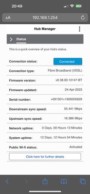

@JohnC2 All changed mate. Not the jump in speeds I was expecting but at least we are on the right profile so thanks for your help! That was from last night I got my partner to send me a screenshot

looking better now but as expected little movement in down speed but big jump in upspeed
