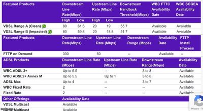

I’ve done the well known broadband checker online & got these results for my new home:
Can somebody let me know if it looks like FTTC looks possible. I am getting a new landline activated on June 13 at this property. The broadband goes active the same day too but 2-5 Mb is not going to be sufficient. I have read elsewhere that a week or so after the phone line goes active, if I call back they will say I can get Fibre.

Yes, you have FTTC there. It is VDSL in that table. It looks as if your BT app thinks you only have ADSL2+. What does your online BT Home a/c say you've got for your BB?

No, that tables shows FTTC (VDSL) is "Available".
