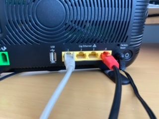

Sorry, when you say modem do you mean, to me.  the router box?    If so, the router has not changed Displays blue light when worked on old copper wire). The same router  with the big circle on the front.  It has a purple flashing light.
i got a new cable to plug in to slot 4 on the back of the router and to the new box on the wall.

There should be two devices, a box on the wall with lights on it which is the ONT, and a BT Smart Hub 2 which is connected to the ONT with a short Ethernet cable. Both units have their own mains plug, and should be turned on.
Its the lights on the ONT which I was asking about, (LOS, PON) which ones are on, and are any flashing?

Is there a lead from that unit, to the BT Smart Hub 2  Red port?
Its possible that the settings on the Smart Hub 2 are wrong, as the newest version has an "FTTP MODE" option, which needs to be enabled on the smart hub managing page, as it would have been disabled when you were on a copper connection.
I do not use a BT Home hub, so I an not sure where the setting is.

Hi I have this
When I spoke to BT we signed into the admin area and changed the copper settings to fibre.
