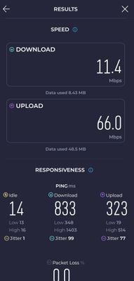

 got full fibre installed a month ago i am having to reboot my router daily as download speed is dropping to 12Mbps with an extremely high ping, reading this is a known fault on the hub 3,  something to do with a bottle neck ? Im at my wits end.

This results of a bt speed test.

No faults show up because blue light stays on not fully dropping out still running at 10 or 12 Mbps which is a safety setting im informed
