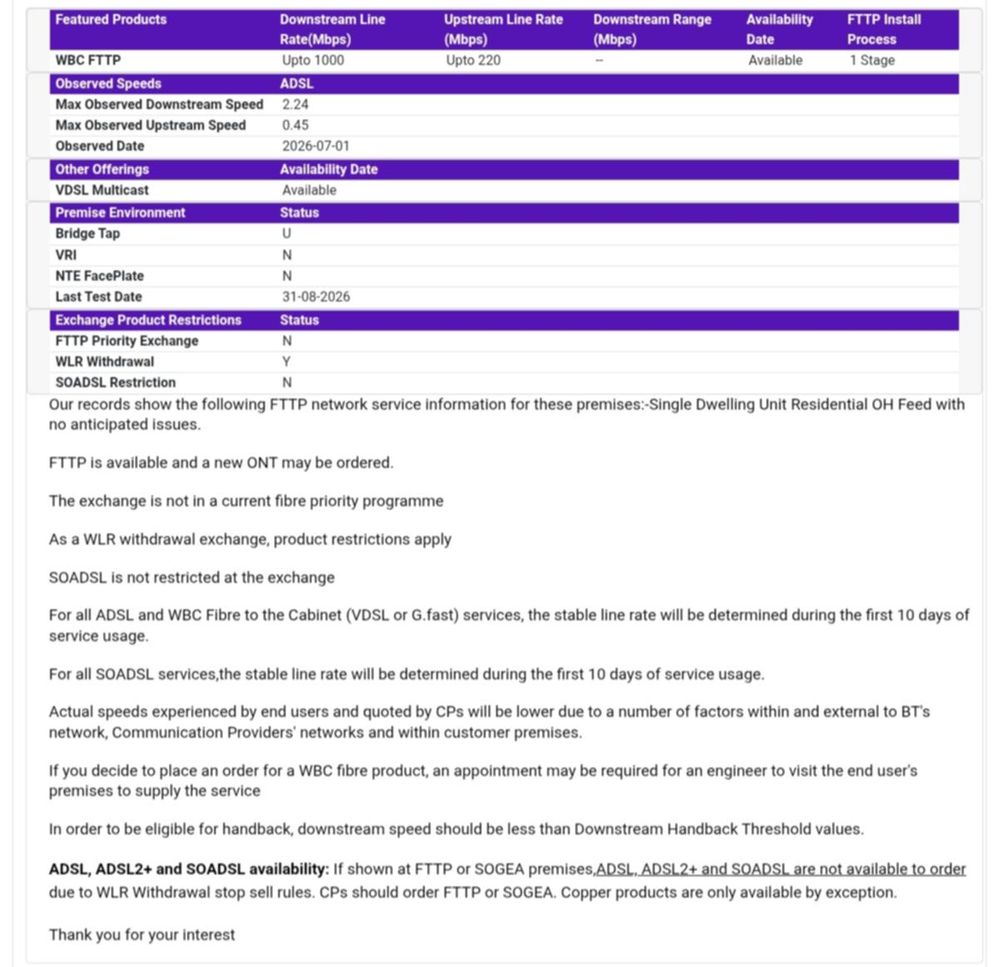

The checker shows fibre is available, just order it.

It's quite acceptable to use an extension lead with a double socket, if you are happy with that.  If the current line comes in through a window frame, that might be a problem as current practice is not to go through window frames.*
I can see your results from the checker now.  (Images go into quarantine until a moderator releases them.  Only the mods and the community leaders can see them in the meantime).
OH means overhead, (UG is underground), so it will come from the pole.  Says no anticipated issues, meaning the survey does not expect any problems with the install.  Next to WBC FTTP it also says 1 Stage, meaning the install will be done in one stage and one visit.  (KCI 2 Assure means two stages, external work then the internal install).
*Edit:  While I think about it, it might be worth mentioning that you can have up to 100m of cat 5e ethernet cable between the ONT and the router.  That would be your responsibility, but cat 5e cable can be bought in supermarkets today and it's just a matter of plugging it in.
