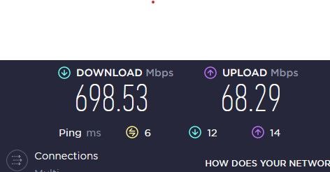

Re: FTTP - 500 to 900 Upgrade - Slowness Since Upgrade
Smart queues are turned off. Speedtest rusults vary but generally sit around 700 down and max out at 70 up.

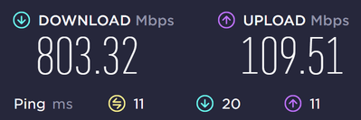

Do you have any threat management turned on to detect , or detect and block or it turned off ?
Here is mine with Detect & Block (medium sensitivity)..
Detect only (medium sensitivity) ..

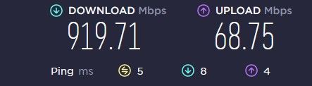

Normally I do, but I've turned it off.
I'm in the process of wiping the UDM-Pro.  So far it's looking positive as in the download speed is now 920Mbps (solid) but he upload is still pegged at 70Mbps.  It flips up to 110-120 for a blink of an eye then down to 70 again....  Small progress I guess.

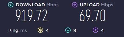

My upload won't budge...  Download has improved.

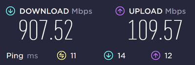

I just need to sort out the upload now....  For a brief second it hits around 111Mbps upload then drops down to around 70Mbps.  Accessing my NAS remotly or streaming Plex out of the house is almost impossible now.  Fairly confident it's an Openreach setting as it was fine on the 500 package.
Another test this morning.  It's consistently in this range.

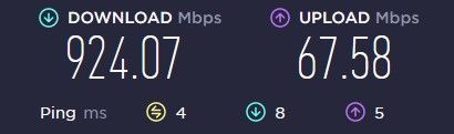

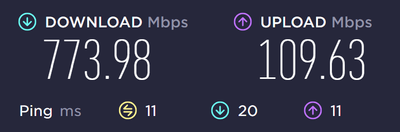

Connected BT Smarthub and it's the same.  No change (technically speedtest should be faster as no one else is connected to this router while I did this test).
