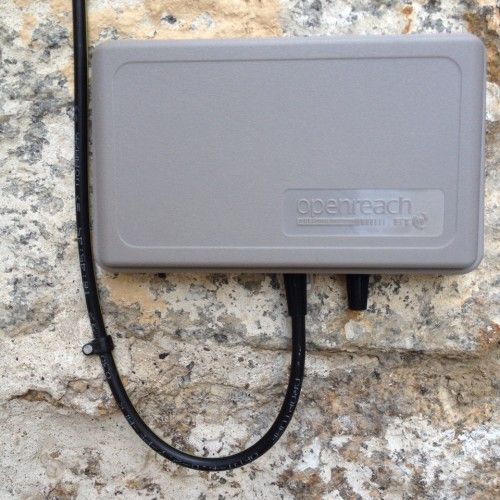

Thanks everyone for the replies, sounds like they will not dig up anything without asking me and after doing a survey,if BT can use my existing duct ( if not blocked)  ..does that mean i do not have to get their external box fitted to outside wall or will i always need to get that fitted? external-openreach-FTTP-customer-service-point--768x576.jpgopenreach.jpg

You will have the external box - customer service point - fitted. Cable may enter the house there or you can ask for the cable to be routed around your property to an entry point of your choice. At the entry point the modem - ONT- will be fitted and you’ll need a 13a socket. The ONT connects to a Hub by Ethernet cable. The Hub also needs a 13a socket. Have a search on here and you’ll find lots of example installations.
