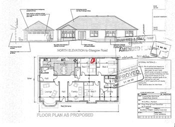

Thank you very much, Jane, albeit a bit scary.  Is it possible to put a wifi booster in each room or is that wishful thinking?
My house is a bungalow 20 metres x 10 metres

Thank you once again,  WSH.   Yes, I tend to go into things too deeply.
My house is a 20 year old bungalow, 20 metres by 10 metres and the walls  are stud and plasterboard.
My router is currently in the front of the house and middle for diddle and next to the front window and works great.  However, for the wire to come in it would involve digging.  Therefore I hope the wire can come in at the rear  from a pole and through the wall.  If so, it will be off centre a bit.

Right, in terms of where the fibre cable will come in, that's already been covered, in depth.
If you have stud and plasterboard walls and the Wi-Fi only has to go through one wall, a single Wi-Fi point, more or less centrally positioned & high enough up to avoid obstacles will almost certainly suffice.  If not, you are unlikely to need more than one extender  at most.
One in each room is unlikely to be necessary nor will it be practical.  With something like a mesh system it is recommended to keep it to no more than 3 nodes, as it just becomes too "extended" for it's own good.
Edit: Oh, and incidentally, putting it by the window just means that half the signal goes outside.

You've made me wonder what's in the picture now.  (Unfortunately, us mere mortals can't see it until a moderator or a community leader releases it from quarantine).
