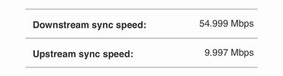

@Hamble_Riverwrote:
You appear to be saying that even after signing up to Fibre 2 BT refused to lift the cap on the line?
That is correct. I queried it and CS said it wouldn't go any faster, which is almost true for download, but not for upload according to the Smart Hub.
My current sync speed (55/10):
My maximum speed:
So it's not much, but I really want to unlock any extra upload that is available.
