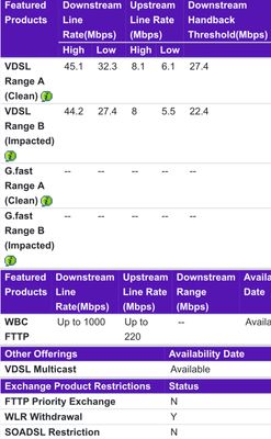

Hi guys, thought I’d check again and looks like there’s been an update
Our records show the following FTTP network service information for these premises:-Single Dwelling Unit Residential UG congested duct.
FTTP is available and a new ONT may be ordered.
The exchange is not in a current fibre priority programme
As a WLR withdrawal exchange, product restrictions apply
SOADSL is not restricted at the exchange
For all ADSL and WBC Fibre to the Cabinet (VDSL or G.fast) services, the stable line rate will be determined during the first 10 days of service usage.
For all SOADSL services,the stable line rate will be determined during the first 10 days of service usage.
Actual speeds experienced by end users and quoted by CPs will be lower due to a number of factors within and external to BT's network, Communication Providers' networks and within customer premises.
In order to be eligible for handback, downstream speed should be less than Downstream Handback Threshold values.
If you decide to place an order for a WBC fibre product, an appointment may be required for an engineer to visit the end user's premises to supply the service
ADSL, ADSL2+ and SOADSL availability: If shown at FTTP or SOGEA premises,ADSL, ADSL2+ and SOADSL are not available to order due to WLR Withdrawal stop sell rules. CPs should order FTTP or SOGEA. Copper products are only available by exception.
Thank you for your interest

It means Openreach can accept an order for the address , it’s not always the case that your ISP (as you are posting on a BT forum I’ll assume it’s BT you will use ) is also ready to proceed (they may need to provide cable links etc ) but assuming BT  are also ready then you should be able to order  …..the SNN (survey network note)  is ‘congested duct’ so it’s possible that some work will be needed to get a new cable from the footpath to your house wall , so any date given may be changed depending if the ‘duct’ is viable or not .
…you have clipped some of the relevant information on the checker which states if it’s a single stage or KCI2 (two stage ) installation , I’d suspect it probably going to be KCI2
