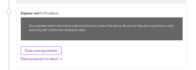

My order is now down as delayed as they need to understand how to connect me to the network?
I have been told I need to have a DIG completed to have the fibre installed from the pavement into my house.

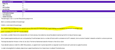

Try putting your address details on the DSL checker
If FTTP is available your address it should say something ‘UG feed to curtilage hard’ which signifies to the ISP that it’s a two stage install and they shouldn’t give a proper appointment for service , but an appointment for the survey, if the DSL checker states something else then the initial survey was incorrect

Thanks for quick reply. No initial survey as far as I am aware.  Circet did the initial install on pavement so suspect this might be close by in one of the new burried manholes that were recently installed? All I have is new bleue plastic tally stamped into pavment.

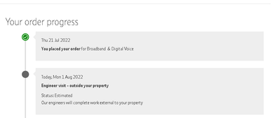

I checked this, see below. Looks like I also just need to wait as on strike today?
