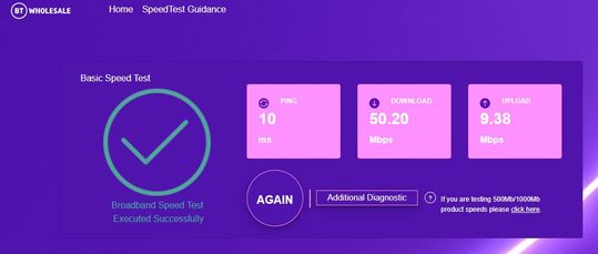

My contract recently ended and I was led to believe fibre 2 would be an upgrade. It's been a couple of days since the service activated and I set the new hub up, but the speed is no different. I've already looked into this a bit and am aware that the line can only support a certain speed, but I would have hoped they'd only sell me an upgrade if they knew it was actually going to be one.
I just did a test and am getting 50 / 8.5 at the moment (wired connection to hub). After looking at other threads, I saw people were requesting the hub settings be checked. I had a look and mine says

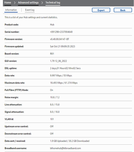

Maximum data rate:18.493 Mbps / 61.374 Mbps
Was hoping for some advice on what I might be able to do about this? I know BT normally say it takes up to 10 days for speeds to settle. Is that genuinely something that makes a difference? I don't want to wait 10 days just to find I'm not going to get any faster, then it leaves very little time to cancel during the cooling off period.

can you also post the stats from your hub

and here are the stats. Please just let me know if you need anything different.

you are still on fibre 1 as can be seen with connection speed limited to 55/10mb

The upgrade to F2  ( once it’s progressed , assuming it hasn’t been done yet ) given that F1 is 55Mb , and your max attainable is 63Mb , after allowing for overheads etc , your throughput speed ( when using speed testers etc ) is not likely to show that much improvement , possibly around the  high 50’s -60Mb range .
The  DSL checker ( the link works OK for me ) will provide a prediction for the speed you should expect ,
If 63 Mb is lower than the predicted speed you may have an issue, (the noise margin doesn’t look great on your router stats )  if the prediction is reasonable, then you may not see much difference ‘real world difference’ between F1 and F2 , there is potentially more ‘benefit’  in the upload speed which may be make the change worth it
