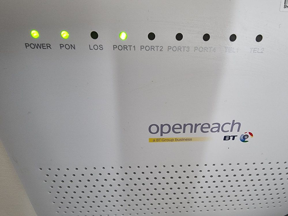

Hello folk,
I've got an engineer coming around on the 15th April, but just seeing if I can figure anything out in the mean time.
Details
  • I have the Openreach (ONT) (FTTP)
  • It was working just fine using Google Wifi mesh
  • Internet access suddenly dropped
  • Switched back to using SmartHub2 as part of diagnosis - no Internet (orange light)
  • ONT has green light for PON, Port 1 and Power (no other green lights)
  • Have performed factory reset of SmartHub2, tried a different Google Wifi device and reset the ONT.
  • Have tried different ethernet cables from Port 1 to the SmartHub2
  • Bills are paid and up to date
The first line support have run checks and can see no issues going to the ONT.
So my thoughts are that whilst there's a connection to the fibre network, something has gone wrong in terms of getting access to the Internet.
Any thoughts?

Depending upon which version of the ONT you have, is the LOS/Alarm LED lit?

Thanks for the reply.
No, only the lights mentioned - PON, POWER and PORT 1

Just to be clear, here are the lights:

The Openreach part of the connection is OK ( indicated by the solid  PON light ) connect your BT hub to the ONT , possibly with a different Ethernet cable to the usual one ( to eliminate it as the problem ) what is the status of the Hub lights ( once it’s had chance to sync )
https://www.bt.com/help/broadband/fix-a-problem/broadband-and-wi-fi/i-can-t-connect/what-do-the-ligh...
A solid Orange light can indicate an account issue, you are connected but are being denied internet access.

Try connecting a PC/Laptop directly to the ONT and set up a PPPoE connection
Username [email protected]
Password BT

When you re-fitted the SH2, did you remember to set the FTTP soft-switch in the hub manager

Have tried different Ethernet cables, will try connecting to the ONT using PPPoE, I haven't tried that.
I'm not sure I changed any FTTP soft-switch in the hub manager, I did a factory reset though - I'll investigate.

Can confirm FTTP is set correctly.
Have connected directly to the ONT and unable to find PPPoE server after about a minute of trying.
Does this indicate a broken ONT?

It sounds like an account problem to me, is there any reason why you may have been disconnected
