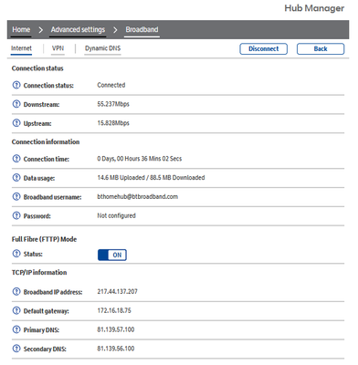

Hope that is what you wanted?

Can you post the screen at Advanced Settings> Technical log> information.
Error rate refers to line errors not exchange problems.
