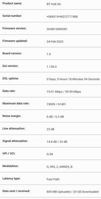

Please post a screenshot from the hub, Advanced settings/technical log/information.

Thanks for coming back. 100% a new cable from the entry point of the house. The previous engineer a few years back switched to the best pair as a run of a new cable would have been elsewhere in the house at the time and I was not comfortable with the options the engineer provided.
With the recent visit, he suggested a new cable was the only option and we agreed new placement in the garage. For this house the master socket is routed through an unknown route to the middle of the hallway. It was tapped at the grey housing box going into the wall, diverted into the garage, where the new master socket (mk4) sits with the router. From recollection it's a thick black cable on the outside going into the garage and then a white junction box on the inside switching to a thinner white cable.
The issue was with the old junction /termination into the house wasn't weatherproof, even though it has a grey thing over it, it lead to water to enter causing the corrosion on the line (or something like that)
See below for the router stats

I suggest you request a DLM reset it will take about 2 weeks. Post back then if no improvement.
