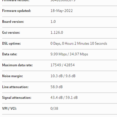

The reason the try a filter in test socket is to eliminate a problem with the faceplate and you can also check faceplate is fitting securely as they can get dislodged

Re: Speed seems stuck on a profile
Go to solution
Yeah, connected onto the test port, and I still get the same . Speed after test port.png
Go to solution
DLM has banded your line at 35M
Go to solution
you down speed keeps coming back at exactly the same speed suggesting stuck in a banded profile while you up speed appears stuck at fibre 1 max.  looks like you need openreach visit
Go to solution
Ok, will contact CS at 150 then
