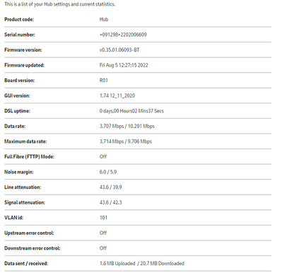

Thought I'd post the line stats as I've checked the wiring to the Master socket and the pair is connected correctly.
4,506 Views
Message 10 of 12
Re: Sudden speed drop
Go to solution
Those stats suggest a wire disconnected between you and the cab. Give customer support a ring, they should see the issue and arrange an engineer for you.
