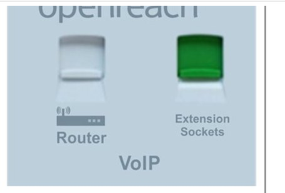

I guess I was not clear the only copper BT is turning off is the phone line - the copper will still carry the FTTC connection.
From one of the other posts it appears that BT should offer to connect something like this:-
But no-one in BT has mentioned this........ Hence my question as to whether my single link to the sockets (via a distribution box) can be accommodated if I renew......
Just for info I do not have any, nor would I need any (they would not be used and just sit as junk), phones in the vicinity of the router, hence I do not need to plug phones into the router......
Many thanks for the reply - the replies are gradually making things clearer.
Rod

That faceplate, although the ideal solution, appears to be in short supply or not available. The workaround is to simply install a new extension socket adjacent to the master socket and transfer the extension wiring from the master to the new socket. Thus isolating your internal wiring from the external incoming line. That socket is then connected to the router's green socket.
