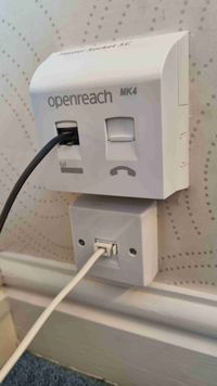

Hi All,
I wonder if anybody could please advise?
I have recently moved to BT Digital Voice, and am happy with how it's working.
However, even though the new master socket faceplate (version 5c) has a telephone socket next to the broadband one, I can't really see the point, as , so far as I can tell, the broadband signal is not carried over this line, so it would not be possible to move the router to a more central location in my house.
I have an extension socket plugged into the telephone point at the master socket, but the router appears not to work on this extension. At least the solid blue light never appears.
Apologies if this is a daft question to the more expert members on here.
Thanks in advance.

@Anonymous  However the extension will be wired from the filtered side of the master socket so broadband will not work at the extension socket unless you move the wires that are currently connected to terminals 2&5 to the data extension terminals. No filter is required as your voice service is DV, although you may need one to convert the extension phone socket to an RJ11 for the router DSL lead.

Just solved this issue, no thanks to the lack of support from BT, by purchasing and installing a mini telephone socket under the BT master, then disconnecting the extension cables from the BT master and connecting them into the new mini telephone socket.  A hole was drilled through the wall and the extension cable fed through to the mini socket.
A standard male to male cable telephone was used to plug the BT Smart Hub into the new extension mini socket.
All extensions in the house are now working again with Digital Voice.
