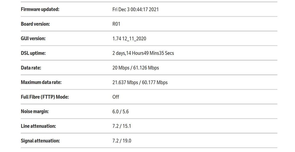

Capture456.JPGHi all, heres an update. My router has not disconnected however I have noticed the margin has dropped to 5.6 and the max speed is now less than the speed I am connected at. Is this bad?

Message 33 of 46
Re: Noise margin change and speed loss
Go to solution
Nothing to worry about, it'll sort itself out over the next few days.
