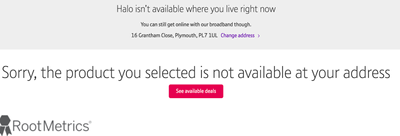

There  is a difference between the selected ‘offers’ shown on the BT website and what’s actually available if someone called BT ( or BT called them ) selected offers are by definition just a selection of offers,  not the entire range , perhaps you can screen grab and post the image showing ‘Halo not available in your area’, as I suspect there may have been some confusion between FTTP not available in an area , and ‘Halo’ .

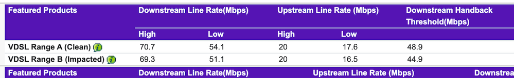

The image of the wholesale checker is the predicted range of speed for the products available to you individually, obviously this varies, customers in areas with FTTP will show FTTP WBC , areas without it ( like yours ) won’t ,  it works by entering BTw phone numbers ( so that’s not just BT Consumer customers,  in the past other ISPs like Plusnet used BTw to supply Telephony for their customers ) and it also works with addresses, so it will work for those that use LLU providers like Sky and TT ( where the checker wouldn’t recognise the Sky or TT phone number because they are not Btw phone numbers )
The  info your image shows FTTC is available ( you may even be on FTTC ) it gives is useful for checking if the speed you actually get is inline with the BTw estimates, but has absolutely nothing to do with ‘Halo’ .

Re: Halo
Go to solution
The screen grab your requested, and which I have taken from website: https://www.bt.com/broadband/halo#!#result
is shown here:

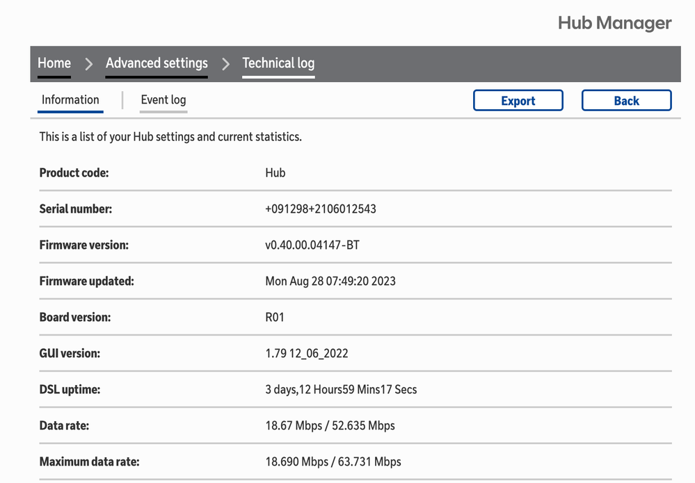

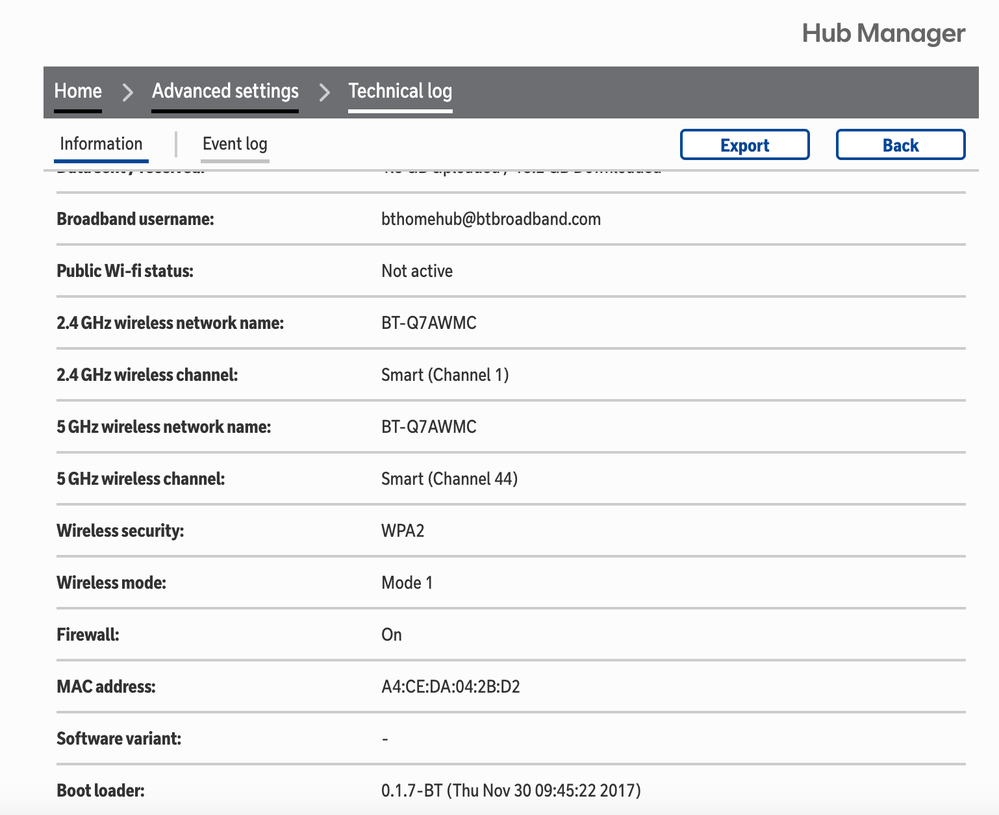

Thank you for your reply, here are the hub stats you requested, sorry, but its in 3 screen grabs:
Screenshot 2023-08-31 at 21.06.41.pngScreenshot 2023-08-31 at 21.07.03.pngScreenshot 2023-08-31 at 21.07.19.png

Your hub stats show connection 52/18mb connection.  With 18mb up speed that is fibre 2 speed not fibre 1
Have you tried connecting to the test socket with filter to see if that improves your connection speed?
As already posted halo is no longer available and only option is halo 3 or halo 3+ .  The options available all show halo 3+ packages available to you

The one outstanding point now is the “Halo” question. Yes, I am being billed Halo 3+, I just keep saying Halo as that is what BT state on their website. Sorry to have caused confusion.
In the post from iniltous dated 31-08-2023 19h40 - edited ‎31-08-2023 19h59. I was asked to submit a screen grab showing BT’s website stating ‘Halo not available in your area’.
I submitted the screen grab in my post dated 31-08-2023 21h04
Message 24 of 26. And shown again here:
This is from the BT website https://www.bt.com/broadband/halo#!#result
So as BT’s website tells me that  ‘Halo isn’t available where you live right now’, and as a neighbour was told by BT when they phoned that they couldn’t have ‘Halo’ in this area/postcode [see my first post 30-08-2023 17h04] I don’t see why I have been, and am still being, charged for a product that BT cannot provide.
I believe therefore that the above proves I have been wrongly charged for the period since February 2020, and quite simply I’d like my money back please.

You should be able to get a significantly better download speed. So as well as trying the test socket, also try a quiet line test. Dial 17070 & select option 2, there should be no pops or crackles.

I was hoping that by using filter in test socket you may increase your down connection speed which is currently just below bottom speed range estimate but above handback threshold.
