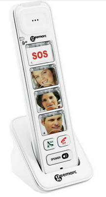

Options:
  • Try another (free) DVA in case it's faulty
  • Relocate the router with a longer cable
  • Run an extension telephone cable to where it's required
  • Return the Swissvoice & replace it with the Geemarc equivalent, for which you can get photo dialling handsets

Thanks, the extension to the wiring is possible but will require lifting carpets (when I say wrong side of the room I mean east west) so either across the room under carpets or right around the room.
i might try another adapter but was hoping for other feedback saying theirs work or otherwise as I’ve not any experience of it actually working
 the alternative phone you suggest seems to also come with a dect phone which might be the answer. As in hard wire the base unit and have a dect handset on the side of the room where she sits.
