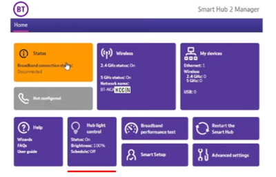

Not my thread, I just linked to it. Credit goes to @Jayebmx but you're free to add your points to the thread.
I don't know the SH2 but looks like the a panel for light control on the home page. Otherwise it's a tape job.
